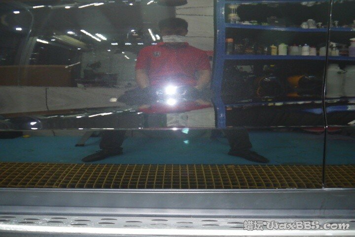

我来为[backcolor=rgb(255, 255, 0)]双腿八字开立站稳好站姿 [/backcolor][backcolor=white]配个图[/backcolor]
